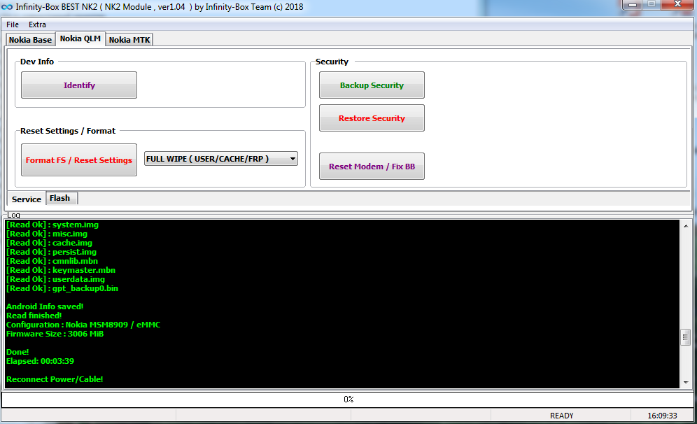

Infinity-Box BEST Nokia [HMD] Module [NK2] v1.04
Nokia__Dynamo_00WW__E1M__600WW_E1M-068R-0-00WW-B0
Operation : Reset Settings [ v1.04 ]
1. Power Off Phone , Remove battery , Insert back
2. Use BOOT JIG or EDL cable! Нужно тестпоинт!!!!
Wait for phone...
Device Found!
Initialize ...
Handshake passed!
BB_IDC_CPU : SnapDragon 210 [MSM8909]
ID_BLOCK_S : 117183E2
ID_BLOCK_I : 009600E1
ID_BLOCK_L : DEC431010399B5327B90312BAD8C51A3
ID_BLOCK_L : 734126AAAE43EDA8C2992DC461F71E29
Use BEST Internal Loader
Loader Sent! Initializing ...
Running FireHose on BBID : MSM8909 , FLASH : eMMC , mVER : 1
MemInfo : 0x0003 / 0x0200 / 0x00000001D2000000 [ eMMC 8 GiB ]
ExtInfo : 0x0001C000/00100000/00001000/00001000/00000200
Boot Ok!
Format USER ...
Format CACHE ...
Format Ok!
Remove FRP
Reset Ok!
Done!
Elapsed: 00:00:15
Reconnect Power/Cable!
